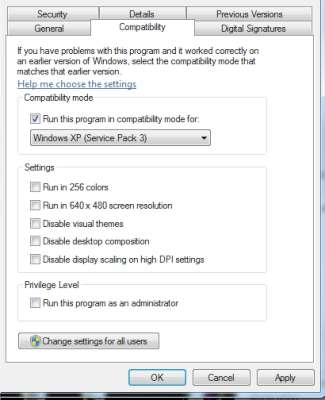

To remedy this situation, do the following:
1) right click the software icon on your desktop and select OPEN FILE LOCATION
2) locate the .EXE file for the main program and right click on it
3) select PROPERTIES then click on the COMPATIBILITY tab
4) place an X in RUN THIS PROGRAM IN COMPATIBILITY MODE
5) click on the pulldown and highlight WINDOWS XP (SERVICE PACK 3)
6) click APPLY, then OK
Screenshot of PROPERTIES COMPATIBILITY tab
Now the program will look for files where they should be and Windows will not redirect the search. Your configuration files will now appear in a list same as before.
