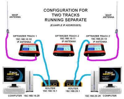

Currently, you are operating each track with a 4520 USB Wireless Unit connected between a USB port on the computer and the Omni Whip antenna. Each 4520 contains a wireless optimizer code to communicate with the lights on one track. When you run both tracks together, you duplicate everything in the tower, two computers, two 4520's, two antennas.
Replacing the 4520's with 4525 IP Antennas will perform the same task when running two separate tracks. Each 4525 will duplicate the wireless optimizer code for each track. The 4525 connects to the computer through an IP network connection, either the IP network at the track or a standalone setup with a simple router not connected to the internet or the track network as shown in the illustration of Separate Tracks.
SEPARATE TRACKS CONTROLLED BY SEPARATE COMPUTERS

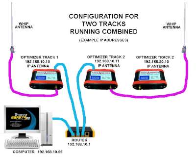

To combine tracks, simply replace one of the 4525 IP Antennas with a third 4525 configured so the computer can communicate with both 4525's. Result is a single computer controlling both sets of lights as a single track. Set full track green and both sets of lights on both tracks change to green. The illustration below shows how both 4525's connect to the same router and a single computer.
BOTH TRACKS COMBINED CONTROLLED BY ONE COMPUTER

Postby ManagerBen » Wed Aug 07, 2024 3:06 pm
I noticed the routers do not have antennas. Are they wireless routers? If not, how do they communicate with the wireless lights?

Postby raceamerica » Wed Aug 07, 2024 4:27 pm
The router's sole purpose is to create an IP network connecting the computer to the 4525 IP Antennas. The wireless communications to the lights is handled by the IP Antennas. If the router had wireless capabilities, the wireless would not be used by the Electronic Flagging System. Think of the IP network with 4525's to be the equivalent to the USB cable with the 4520's.
If the router were connected to a larger network at the track, the IP Antennas could be located away from the computers since the track network would connect the two. This makes it convenient when the Omni Whip Antennas will be on tall buildings and the computer may be located in race control. The diagrams is an example of a standalone network not connected to the track's network. This installation is usually all in the same building due to cable length limitations.

Postby ManagerBen » Wed Aug 07, 2024 4:31 pm
I showed the track owner the diagrams and explained how it would simplify combining tracks. She saw the expense savings with less equipment and less personnel to operate the combined track days. I gave her your main office number to get a quote.
Thanks for the explanation and the diagrams, the picture was worth a thousand words!

Postby ManagerBen » Tue Jun 10, 2025 12:25 pm
I wanted to provide some feedback after we implemented the IP Antennas. This makes things a lot easier to separate tracks for separate races and then combine the tracks by simply replacing one of the IP Antennas with the third unit. Swap the antenna, swap the ethernet cable and ready to go. Sweet and simple. Great design!
