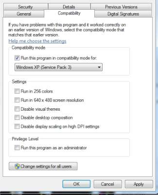

Screenshot of PROPERTIES COMPATIBILITY tab
Now the program will look for files where they should be and Windows will not redirect the search. Your configuration files will now appear in a list same as before.
